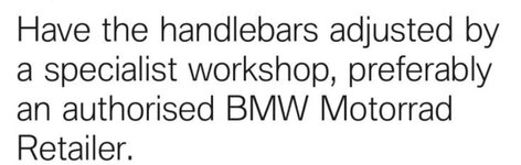

Hi all - need some advice.
I want to know if my bars are at 0 or 10 degree rotation but cannot see where the datum line is. It is a 2020 low chassis so think it should be on zero as i have never touched it from new. I have checked the manual (see pic) but it does not show much detail.
Where are yours set to ? I think it is supposed to be the gap in the clamps??
Any help appreciated.
Rowle.

Gap is always to the rear
The mark should line up with the front joint
Funnily enough I wondered about this too
Seems it is to do with the fitting of OE handlebar risers
Page 6
https://manuals.bmw-motorrad.com/manuals/WEBA/IN/BA-INTERNET-COM/PDF/77015A3BBB4_Lenkererhoehung_0M01_01_202011.pdf
But I suppose you can alter if they suit without the risers
