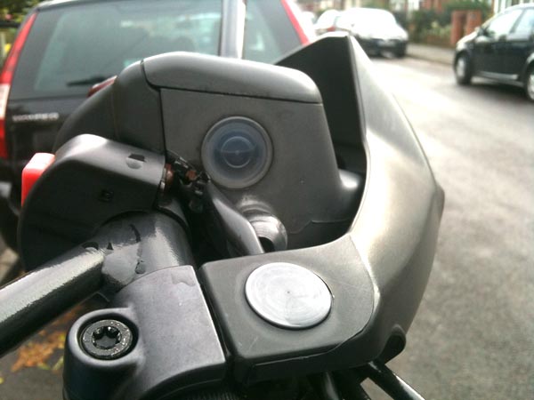

Stop slipping the clutch and at least try to check the simple things - can you see a bubble of air in the glass window on the clutch cylinder or not? In fact, did you check the lever or not? Seriously, you could check both of those in 30s without having to wait for the weekend.

Checked the clutch fluid reservoir and seems fine too:
I guess I'll have Steptoe take a look when it has it 24k service.
