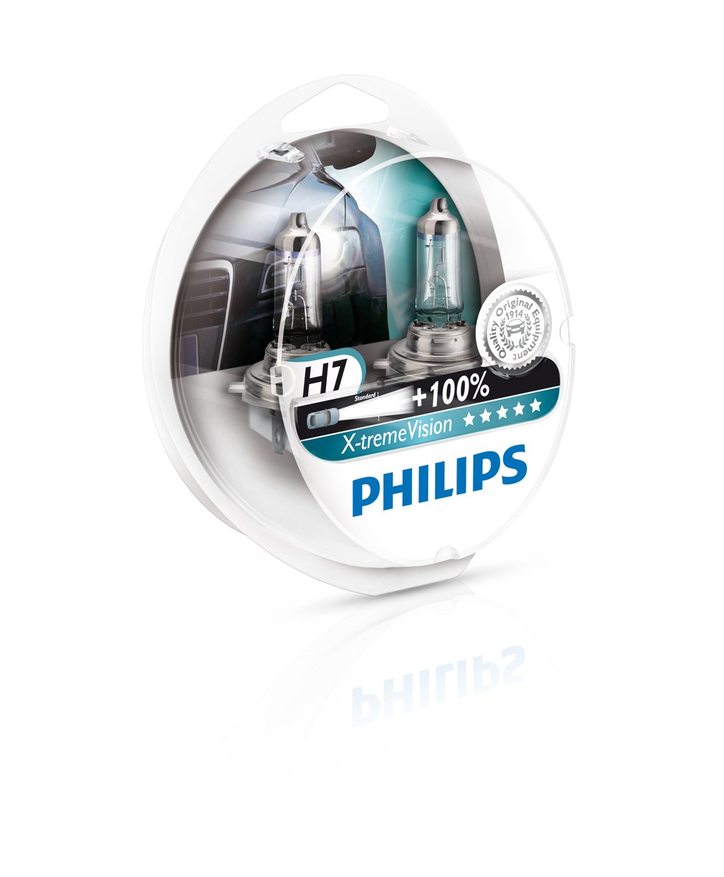

Are there any recommended suggestions for headlight bulb upgrades? Planning ahead for winter, Im wondering if there are any brighter bulbs that could be fitted to my 2009 GSA?
Just go buy a CAN bus compatible HID setup. You can get upgrade bulbs that are a little brighter but the trade off is cost and life span. HID is brighter and lasts a long time.
Great. So this one perhaps?...
http://www.amazon.co.uk/Philips-129...&keywords=philips+extreme+vision+h7+motorbike
I always upgrade my standard bulbs. In the last year I have 3 of the Philips/Osram brighter bulbs fail. One on my car the other two on the GSA. It is worth carrying a spare. Although with both lights having the same bulb you always have the option to rob the high beam.
eurocarparts were about £10 cheaper than anyone else for a pack of 2 when I got mine about 6 months ago
Great help, thank you.
