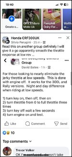

My first thought was that it needs a re-calibration of the TPS.
Maybe a marque forum search might deliver a DIY method, without paying dealer diag fees?
I saved this months and months ago in case I ever needed to do it on my bike.
Hopefully helpful…
