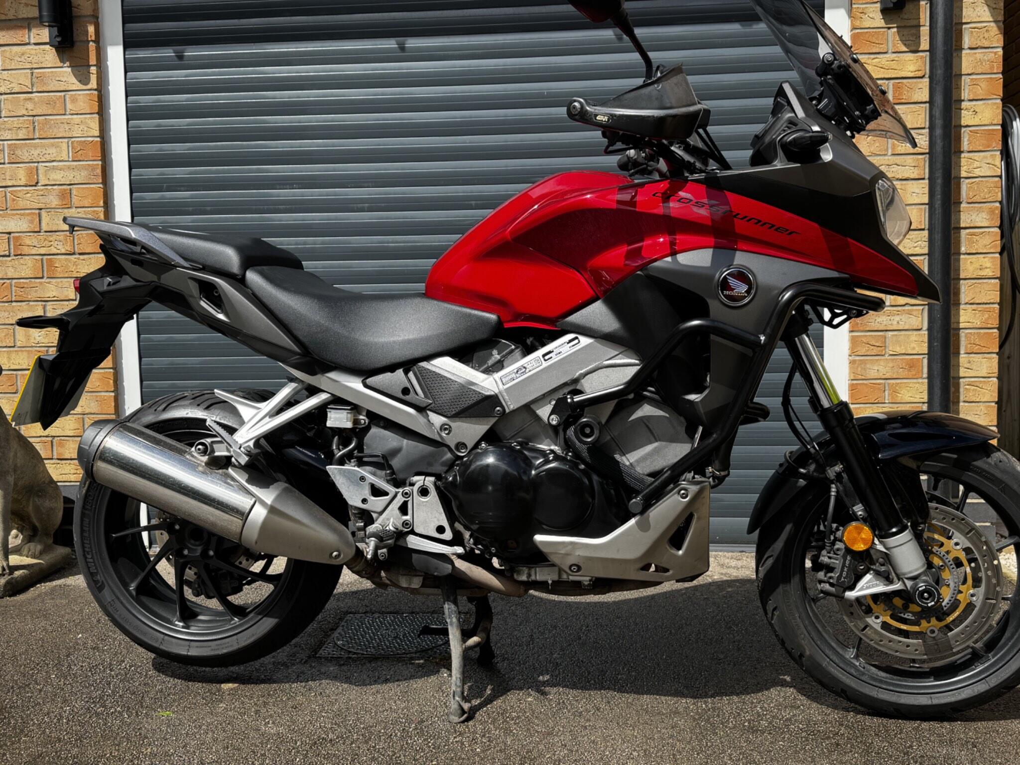

I still think the VFR and the R1150Gs were the best two bikes I’ve ever owned. Quite a while later I bought a Honda VFR800 Crossrunner, Mk1 version which was based on the VFR VTec. Although a good bike in its own right, it lacked something. Couldn’t put my finger on what exactly. I would happily have done without the VTec and had the linear delivery of the Fi. It seemed to me to bog a bit low down and then get a little frantic higher up. My old Fi had a Power Commander which smoothed out the part throttle town riding, which the Crossrunner didn’t so it may have been a case of too many uninvited interventions in the power delivery. Even now I still get a bit dewy eyed when I see a nice Fi advertised.

(Having said all that, you can get a 2016 ish VFR800x...crossrunner, for not much more)

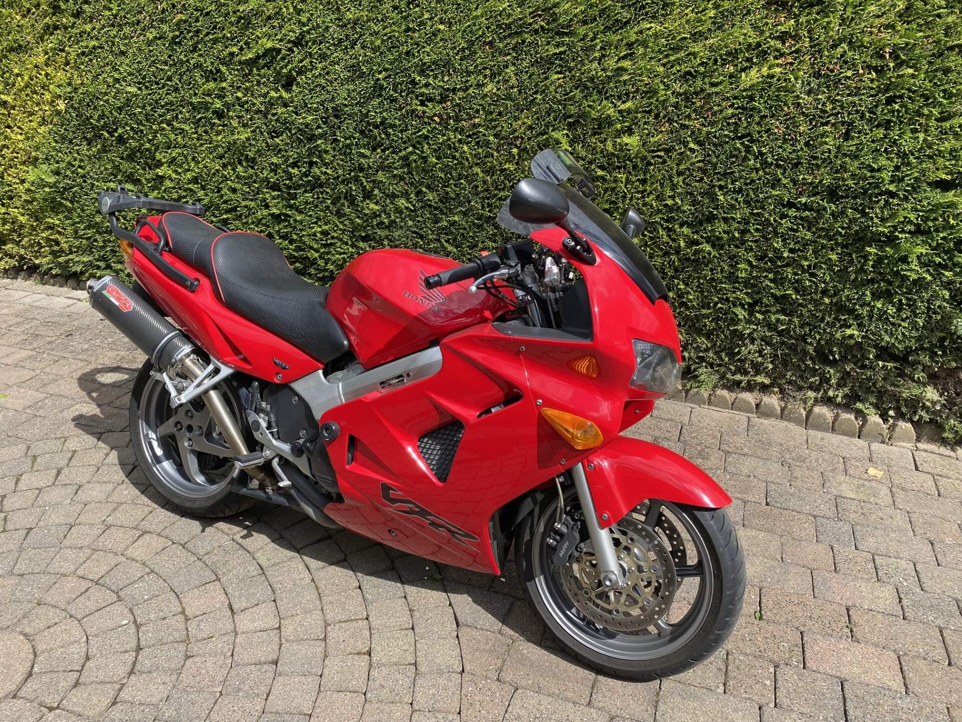

Saw this today on Gumtree, thought you might have some interest, Don't know the bike or seller, looks immaculate.
