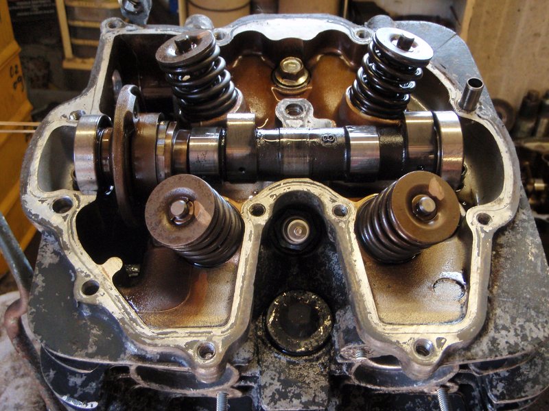

With some of the big XRs I think you need to look out for camshaft wear because they run in plain bearings.

No you are right...my XR600LM cost me a damned fortune to have the head rebuilt ( I'd forgotten about that !:blast )
:D I think there's a fix which involved machining out the bearing faces and inserting roller bearings. Is that what you had done?

The problem was usually the centre bearing, I think the fix was to fit shell bearings because the camshaft is in one piece, maybe roller at the ends? Complicated fix. The 650cc version lived-on until quite recently.

I had a 650 Dominator last year - that had roller bearings each end of the camshaft.
I think you`d have to go a long way back to see the cam directly in the head, even the `87 parts fische have rollers on the cam.

I had 2 XR500's, around 1979 vintage they had cams which ran directly in the head
