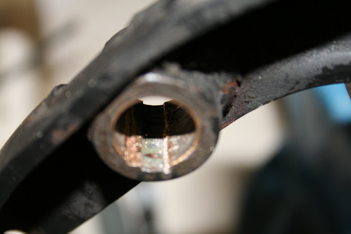

Hi all,
On my Katmandu special everything is nigh perfect. One niggle is the rear brake lever: the bush has worn.
Anyone have any ideas on how to replace this. It isn't covered in my workshop manual
Item 2 in the diagram
Never replaced one but if you can get a hacksaw blade in there and saw through the bush , that would give enough play for it to be knocked out. Or use a length of bolt passed through and use this with appropriate spacer at one end as a puller when the nut is tightened. Gentle heat on the lever before the replacement bush is tapped home :-)
As above or you could get a reamer and, well, ream it out.
Don't use a drill. It''ll grab the bush and bad things will happen.
When you drive the new one in, put the lever in boiling water, and the new bush in the freezer.
Should go in easy.

ok thanks for the replies.
I don't have a reamer so will try the hacksaw blade idea.

1st half done
followed advice and...
2slots
then easy to push out the old bush
and clean up with emery
hope putting in the new one is so easy!
