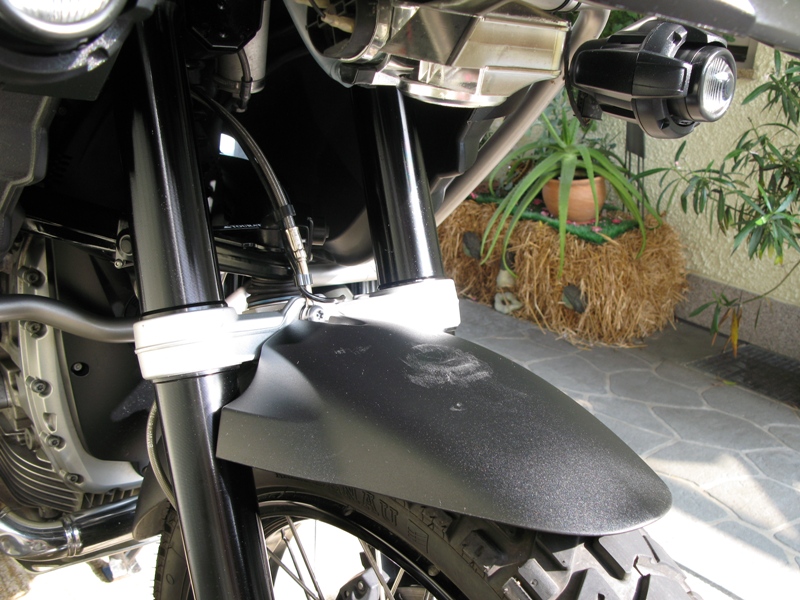

4cm tall Wunderlich Cyclop light got smashed.
You have 22cm suspension travel and theres 23cm clearance between fender and crash bar under the beak. So everything else than a sticker on the fender is too much. If you dont believe me, tape for example a disposable paper cup on the fender and ride over few cross walk slow down humps.

Think that proves my point. New fork seals anyone?
At least I like my suspension travel to be limited only and ONLY by its natural limit, not something that will burst in pieces on even worse, bust my fender and tire.
THERE IS NO ROOM
