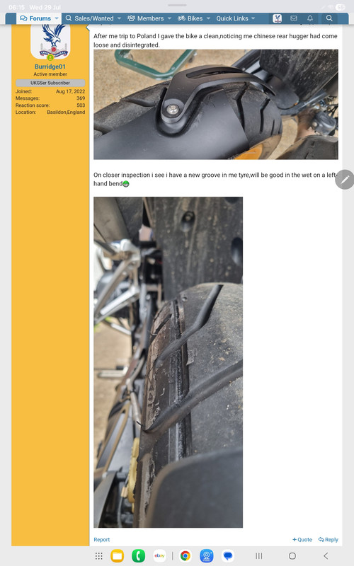

Looks like i had a very lucky escape on me GSA1250
Only noticed when I got back from Poland.And yes,the fixing bolts had slightly worked themselves loose.
Still got the tyre on :D

If you look at the picture he posted he said that is Chinese.

It wasn't the hugger that originally failed,I think the BMW bolt worked it's self lose,as both were loose when I took it all apart.As for buying cheap Chinese stuff-some you win and some you lose.
