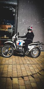

After 20 years of reservations a bought a Beamer, one of those that captured my attention since my teens! Always loved the look of it!
1989 model with 48.000 miles. The bike had a good restoration already. Bodywork is in perfect condition although not with the original graphics.
https://www.ukgser.com/forums/attachment.php?attachmentid=561596&stc=1&d=1678399239
Frame was repainted recently and is immaculate. Engine is very clean and seems to run extremely smoothly. Starts and pulls very well.
There is a tiny little oil leak after long use coming from the oil sump. Possibly a gasket problem.
After few miles I noted a vibration at mid revs and on throttle release which is more evident at empty tank. I think is the tank a bit loose or something there about.
Spokes are ok but nipples are rusty. Y exhaust connector is bit rusty too. Otherwise no rust.
Keys are copied and there is no lock for the seat, tank tap and panniers.
Speedometer glass is old and has some condensation.
The plan is to complete the restoration to return it to its original graphics, rationalise keys, make it rust free, change front springs with hyperpro and shock with an ohlins. Front disc changed for a larger one.
All bushes and bearings changed for new, Seat cover changed for one in original colour (unfortunately the proper original doesn’t seems to be available), new tyres, full service, new gaskets, perhaps a lithium battery and anything else that I will discover needs fixing as I go through it.
I am sure I will need several advice as this project unfold, I am aiming to finish it by the end of May.

Looks like an r100r seat - might explain the lack of a seat lock? Slightly lower than gs version IIRC.
I think the graphics look great, I'd be leaving those alone.

Second photo shows a blue seat - ? But a grey/black one is R100R style, yes, they are same height as R80/100GS and have the same locking mechanism arrangement.
It looks like a great bike!
It does indeed look like an R100R seat. And none the worse for that.
Why change the graphics? They look good and are appropriate to the model's history. I'd leave them be.

1) Current graphics are nice but are not my favourite and not the original for the 1989 Alpine White R100GS. I ordered the original one and the warning stickers from Heritage Stickers. The current one are nice but were used on the G/S Paris-Dakar with the larger tank...I believe.
2) Seat I believe is the original but the cover is not. Colours are not the white alpine; and it is terribly slippery. I bought a new cover in the original white and blue combo, however, I couldn't find the cover with the GS logo. It is no longer available. In fairness I would have opted for an higher version if I was to buy the whole seat.
