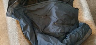

Made a flying visit to Cornwall this weekend. Thankfully i had my heated jacket to fend off the rather cold weather! The Warm & Safe jacket has been one of the best pieces of kit I have ever bought. I can't recommend it enough.
But enter my problem. On returning to London, somewhere along the A40, in traffic, I could smell burning...somehow I realised the smell was fabric burning. I pulled over, opened my jacket to discover a melted hole in the heated jacket working its way into my layers of clothing! :eek:. Needless to say I disconnected it immediately.
Earlier in the journey, on the way back, i now remember the satnav froze, so I stopped and rebooted it. All was fine. Other than that, all was well until i discovered this burning smell... Are they connected?
The jacket is plugged into the Aux socket under the seat - I thought this only allowed 5amps through? But if the alternator or Regulator/Rectifier is dying, could more get through? Could this be what happened?
Can I test the alternator? Would a GS911 show anything? The bike is due for a service so maybe this should be added to the list pronto. But I have had experience with screwed RRs melting important things!
Grateful for any tips on how I might check the alternator.
Cheers
Here are a couple of images.

Stick a volt meter in the battery while running. 14.2 volts should be about as high as it gets.
Personally I think your jacket failed, if the voltage got high enough to fry it you would have other issues like fried battery and possibly other electronics on the bike. You would also have noticed the jacket getting really hot in general.
A voltmeter will reveal all though.

The problem is with your jacket.
To be honest, that's where my thoughts are too... I called Terry at Riderz.xo.uk this morning but he suggested my bike is the problem

With yours though i'd say it's a localised short that has caused the issue
Looking at the jacket it looks like the element has shorted out in that section as to over voltage from the bike I personally think its unlikely to make the fault occur unless the insulation was very thin in that section.
It seems most of you agree with my original thinking... that's it's a fault in the jacket. I'm hoping it turns out to be as I think they'll honor a replacement (I vaguely remember W&S offering a lifetime guarantee, but I could be wrong - I at least want them to see it... this could have been a different story if I wasn't wearing so many layers...).
I'm going to get the DVM into it, see what I get, then send the jacket over to Riderz.
Sent from my SM-G975F using Tapatalk
I would assume a thermal breakdown of the insulation on the jackets heating element rather than a power supply issue. If your voltage regulator provided excess volts the current draw would correspondingly reduce as the overall power draw of the jacket should be constant.

I'd say it just confirms the jacket is at fault ;)

I think that you are confusing current with voltage. It was high current probably caused by an internal short in your jacket that caused the problem, not voltage. You would have to have one hell of a huge voltage spike for some considerable time for that much damage to happen. If that huge spike had really happened all your bulbs would have blown and probably a lot of other electrical items. The canbus would certainly have shut down.

Thanks for that Rich. I think you're right... on both fronts. The bike is running fine and there's zero evidence of electrical misbehaviour or wires that have been overheated. Additionally, as you say, the Can Bus would have done something or another.
Jacket will go back tomorrow... I'm just glad the weather had improved in time!
