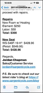

Sargent do heated seat option, I have one on mine. One of the element wires broke and I did a repair. However I also contacted Sargent and I think they were around £300 for one.
Drop Jordan a message and ask about the 22% that they offfered me.
Jordan Chapman
Sales/Customer Service
[email protected]
