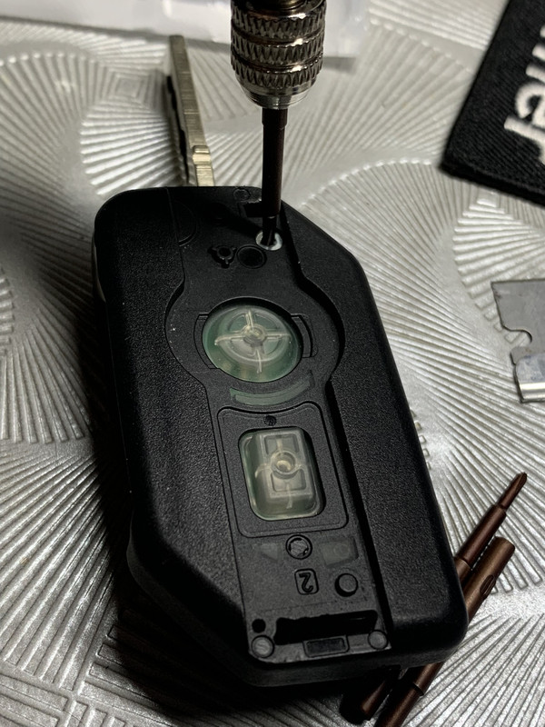

In case anyone ever needs to take their own fob apart i took some pics;
Remove the battery cover and battery - you will see two screws, remove them (i think they`re a T5 - tiny)
You then need to access the `hidden screw` which is underneath the chrome trim piece.
To remove the trim piece a small locating `tang` needs to be pressed/pushed.
If you gently pry open the end of the fob you will see the shiney chrome tang so will know where to press/push your tool of choice to release it`s grip on the fob body - you can just see the tang in this pic;
Press/push to release;
The trim is released;
Very carefully wiggle/rock the trim piece to disengage the other smaller (and very fragile!) tang at the other end of the fob body;
With the trim off you can see the `hidden screw` - remove it with a T6
Undo that screw and the two halves can be separated. Be aware that the key blade is sprung loaded and will try to rotate the fob half as it is removed.

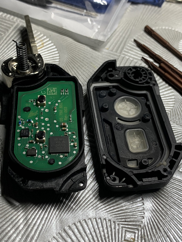

If you want to remove the PCB from the body hold a soldering iron tip on the two peened-over retaining pips whilst pushing the PCB (from the battery cover side) off the body;
I thought i was going to be lucky with mine - see that small bit of green corrosion on the chip?
After cleaning it off it made no difference..
