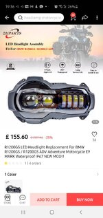

. Price is good right now as well! There is another version - same LED arrangement, but sat behind oval lenses, so it's more akin to the OEM unit.
