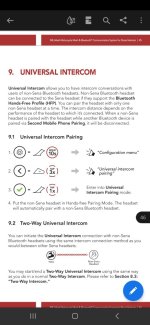

Simply had to put the Edge in Bluetooth mode and then pair the intercoms as you would normally, ie holding down the centre button on SRL for about 8 seconds and the top button on Edge for a few seconds so both are in intercom pairing mode. They paired after about 30 seconds.
I'm going to try this way to connect with my mates. Seems it's really easy to me:
