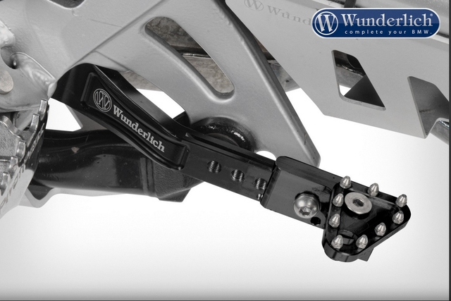

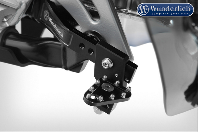

I have the adjustable BMW foot pegs on my GSA. They allow 3 positions, same height as standard, 10mm lower and 20mm lower. The only issue I found with the 20mm lower position is the brake pedal is too high. As said by Smogbob, do not adjust it, it could lead to binding.

In the end managed to get the Footrest to Pedal adjustment how I wanted it by fitting height adjustable Footrests.
