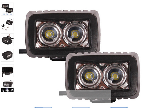

The spot lamps I posted a link to earlier cost about £20 a pair. Ridiculously cheap so they must be rubbish(?) Again worth the punt.
They seem to be machined from billet aluminium and very solidly made. The chrome plate on the bezel flakes off during the first winter of use but its easily peeled off and painted. The light output is a well focussed square shape beam that will light the hilltops miles away. They have an annoying auto strobe function, but the fix is documented on YouTube and easy to do.

I got a set of these for the DRZ I only fitted them the other day and yet to try at night but they seem OK
https://www.aliexpress.com/item/1Pa...-SUV-ATV-4WD-4X4-Offroad-LED/32629284976.html

I got the U5 spots. But the strobe and 3 function settings make them useless as motorcycle lights. Which is a pitty because they seem to have a great range.
I know there is you tube vids on how to fix this, but the circuit on my ones seem to be different. (No U2 chip) Until someone comes up with a fix, the are no good. Its a bit of a crap shoot when ordereing them as they seems to be slightly different versions.
I have these which are great. I would recommend. 30 degree but still light the way very well. Better than the main beam on my VW Golf . https://www.aliexpress.com/item/Fre...32560177409.html?spm=a2g0s.9042311.0.0.Hx9HAy
The U5 strobe feature on mine was VERY easily disabled. The videos on You Tube show removal of the chip and also cutting a link on the circuit board.
This bloke blathers on for 5 minutes to say the fix for non U2 chipped lights is to solder a 10K resistor over a certain capacitor. There are other probably better videos.
