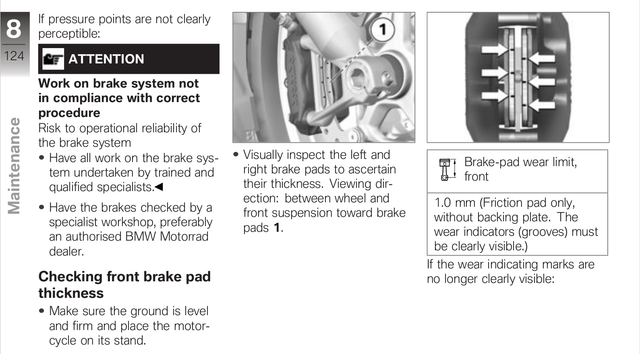

Can anyone offer thoughts on the minimum depth of brake pads before swapping ?

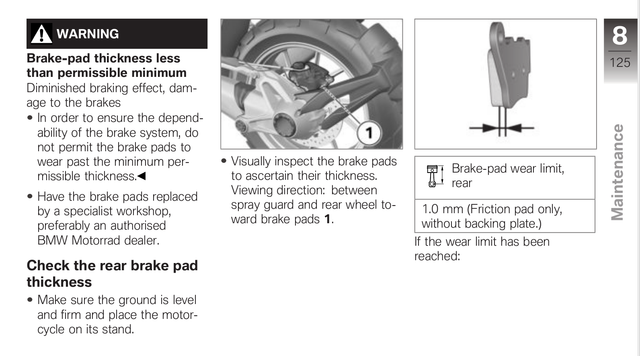

I would swap at 2mm of material left but its up to you. The less material left the more you have to keep checking
The mothership would probably advise at 60% worn.
Nice one![]()
Should have looked in the manual myself really !!!
Cheers.
+1 on that, any lower and they can start to break up, and a new disk is not cheap.
Nice one![]()
Cheers.
No worries it was only when I looked myself I seen that.........![]()
Usual bollox then a back track One minute the pads disintegrate at 60% then it's ok if they're at just above 1mm![]()
Personally I change at 2mm, the extra heat transfer with thinner pads isn't worth the risk.

Thanks for the replies.
Just measured them.
15k miles
Front 4mm
Rear 3.5 mm
Enough for a trip to the Balkans in Sept then a job for the winter
If you are going to be fully loaded like a camel, might be better to just put some new ones at least on the rear it is only 1 set, and only takes half a beer, video below is fun.
Well worth replacing the rears, Gs's do seem to have a propensity to go through the rears quite quickly, peace of mind and all that.Yeah they dead easy.
Took em all out, measured the lining, cleaned them and put them back in.
Might as you say drop a set in the rear
