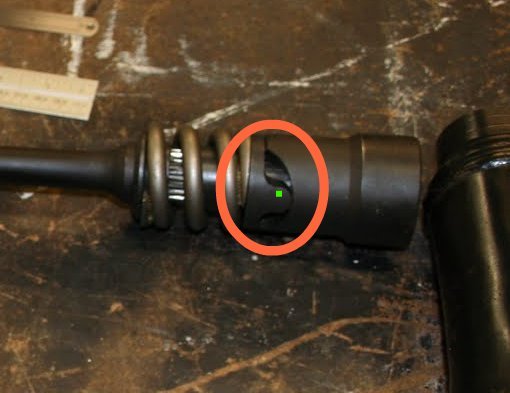

there is wear in the coupling on the shaft but not enough for the clunk i am getting
What does the cush drive bit look like? If this is worn then this can clause a "clunk" when you let the clutch out in first
The one pictured here is good
If the surface near the "green spot" doesn't look like this and has been worn away then this may be your problem
cheers
-Pete
compared to this one my cush drive might be worn more than i thought
