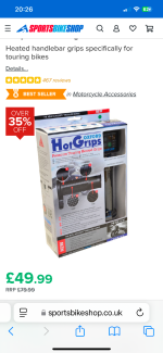

The stock heated grips are not great, but with a bit of care and jiggery pokery you can use the likes of the Oxford grips with the OEM connectors and power them up via the TFT. I have the OEM on mine and I'm not that bothered, I know I should be, but mainly because in the cold months I use a pair of heated gloves, and also have a pair of Hippo Hands which quickly switch between bikes if needed.
