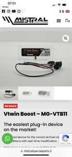

From what little I know about the bike, I’d still recommend some type of reversible plug in fuelling modification. Like the Mistrel one (attached). If you don’t appreciate smoother fuelling and running slightly cooler - then easy to reverse back. I’m sure you could sell the device for minimal losses too.

I'm not a believer in plug-in spoofers but that's a different topic. Stock, these bikes run absolutely fine with no popping and deliver good fuel economy. But if you change to a free flowing collector and or open up the air box, it'll need remapped to run right. As far as going through all that just to save weight with a lighter exhaust I'm not sure you'd notice, I know I wouldn't. The aftermarket slip-on I put on was maybe 1-2 pounds lighter. Changing the heavier collector with cat to a Y pipe will save more weight than that but all that weight is down low under the motor. I actually put additional weight down there in the form of a centre stand and couldn't tell any difference.
