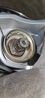

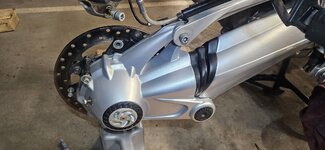

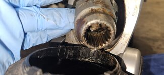

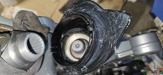

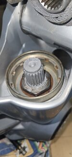

Hi everyone,

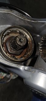

I have just done my first final drive lube on the new-to-me R1200GSA (2010 w/vent) that i bought last august with 140,000 km.
As it's the first time I open one up, I have little experience evaluating the mechanical integrity, so any remarks/comments on the general condition and the job performed based on the below photos would be highly appreciated (obvious mistakes or concerns etc).
The final drive decoupled easily from the shaft and inserting it back was fiddly, but once i managed to align, the insertion was smooth.

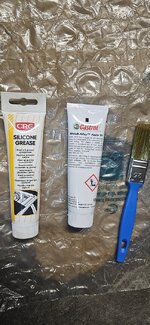

There was rust to clean up (the best I could), remnants of grease and possibly paste, but discoloured. I have tried to research the correct paste and grease, quantity of lube to put on, etc. (No Staburags where I live, on the wishlist for next year).
Best regards,
Einar/

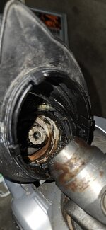

Opening up

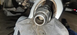

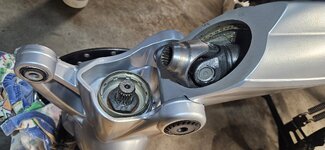

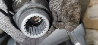

After cleaning up
Lubricant and grease

Your clean up looks good.
The fact it came apart easily is a good sign.
I cannot comment on the particular grease tubes in the picture.
I do have a mini tub of Staburags, but may have used Honda Moly 60
Looks exactly like mine and I use Honda moly
Thank you that's reassuring! Yes, I was relieved it came apart, few dents in the housing, possibly someone has had to knock it loose at some point earlier in its life.
Great that's good to know. I purchased what I understood to be the OEM paste (Castrol).
For the accordion boot seal, I was surprised to see it was a transparent grease and not a white-coloured one. Perhaps white is the Lithium-based version, not silicone-based. My understanding is they both can do the job of keeping water out.

Splines look good and I’d say good job done by you!
Great job :thumb2
A moly grease like that is perfect for those splines.
A silicon grease will not chemically attack or degrade the rubber boot.
Thank you all for taking the time to check my work and reassuring me. It was a task I dreaded, now I wonder why... :)
I am however surprised the only separation between the shaft and the environment is some silicone. I will therefore be doing this yearly.
