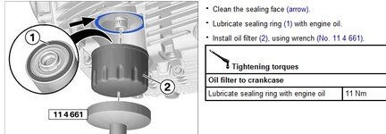

The one thing I haven't sorted is the feint smell of oil. This only started after the oil change. Tightened the oil filter - actually, it was OK and didn't need tightening.
So my only thoughts right now - because there is absolute no sign of a leak anywhere after about 3.75k miles in some rather hot weather, that maybe it's coming from the air box? Does the crank breather pass though it? I definitely didn't over fill on the oil change, but it's the first change I've done on this bike, so maybe something odd has gone on?
I did find a very small amount of oil in the cooling fins oil filling side (it's a TC) - from a dribble I guess? So thought I'd found it. But no...
