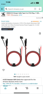

To make it very easier still, buy an SAE to battery lead:
Cut off the two battery terminals and connect the lead to the Thunderbox.
At the SAE end, plug in the USB connector thing and cable tie it somewhere convenient. Wrap the SAE connection in a bit of self-amalgamating tape, to prevent water seeping in.

Don’t worry (though I’m sure you are not) about SAE. Good joke by the way. It is just the name of a very simple plug and socket, that looks like this:
It really is the child’s Lego building brick of plugs and sockets.
I have just bought another C type and conventional USB converter thing.
As you can see, the converter ends in an SAE connection, which will very simply plug into the SAE connector at one end of the bundled up wire. Assuming you can join one Lego brick to another, Bingo! Job done, one end - the power coming out end - is complete. Now all we need to do is think about the power coming in end.
The red and black cable is colour coded. Red is live and black is neutral. Easy.
Now the next easy bit. The other end has to connect to power. The easiest power is the battery. You should never connect something directly to a battery in a vehicle without the lead having a fuse. The lead I bought isn’t fitted with one but I don’t care just yet.
Let’s make it easy for you.
To the bike’s battery, connect a short fused SAE lead, just like this. Red to the red + terminal of the battery, black to the - negative terminal.
Into SAE socket, plug the other end of the lead you started with at the top of this post.
Bingo! You now have power going from the battery, along the cable to the USB converter.

To make it even easier, get hold of something like this:
This will be comfortably long enough to go from the battery to the USB converter in one run. This removes the need for the short flying lead, mentioned in the post above.
It might well be a bit too long but, too long is much better than too short.
Connect lead to battery, Red to positive, black to negative.
Plug the USB converter into the end.
