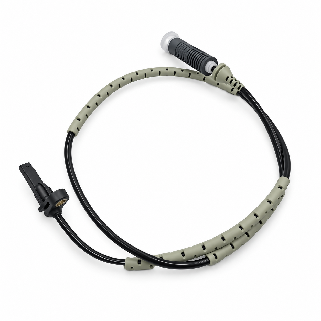

Hi all, had the rear wheel speed sensor throw up codes / fault lights / dead speedo ( then miraculous reawakening) etc. It's going to be the sensor, so is there an appreciable difference between the £100+ motoworks item and the £15-£30 eBay ones? Thanks!
if it fits and works I'd go cheaper version - there is NOTHING sophisticated about them, its just a hall sensor with a budget IPC amplifier chip that's designed to die - likely find aftermarket is more reliable !!!

To answer my own question, I bought an e-bay sensor, UK sourced but Chinese origin, which went in just fine, and has fixed all the speed sensor related problems. Didn't come with an o-ring, so the old one went back on as a temporary fix, new one of those coming from Motoworks and I'll do it all again.
