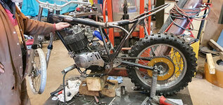

My little brother has three projects on the go at the moment, all of them for off-road use only. He scours ebay for frames and engines and other cycle bits and starts marrying them together.

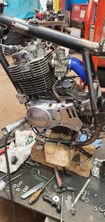

At the moment he has a Royal Enfield 250cc Crusader engine in a Montesa frame, a mid 80s Honda XR250cc which is nearly complete and the frame and parts are at the powder coaters at the moment and this latest one. It is a Triumph or BSA frame, possible a TR5 or maybe a BSA B50 frame from when the two companies were amalgamated, a Suzuki DRZ400 engine, Honda front forks, Yamaha triple clamps, Bultaco rear wheel. He has mounted the engine using Suzuki GSXR 750 engine mounts with the rubber isolation, the tank is a Cheney Victor and I think the seat is a new BSA item. The air filter housing is from a 1960s car and is very reminiscent of the air filters used on Husqvarna motox bikes in the 60s.
He does all of the welding and fabricating himself but he does lack a lathe which he would love to have.

Respect to your Bruv LS :bow
That bike definitely has a certain 'look' to it :thumb2
Cheers, I think it will be a cracker when it is finished. He is creating them in a building at the farm where he works, he has worked there for years and is responsible for maintaining all of the farm vehicles and machinery. He has access to welding kit, a bandsaw, grinder, cutters and other tools but as I stated he does not have a lathe. He fabricates all of the bracketry himself but when he needs things like spacers turned and created he has a mate who works at GKN who does them for him.
Talk about a garage full of bitzas! Your bro’ wins first prize. I had an Enfield Crusader back in the day, keeping it oiltight was a challenge, I recall lapping the head to the barrel and bluing it, it was always the pushrod channel that leaked.
LOL! He spends hours scouring ebay for engines, frames and all sorts of stuff, he says it is his disease! :blast He got the Crusader engine off some old boy who had had it in a garage as a box of bits for donkeys.
That DRZ engine looks great in the BSA frame. It could end up being a really rideable classic. Please post more pics as he makes further progress.
