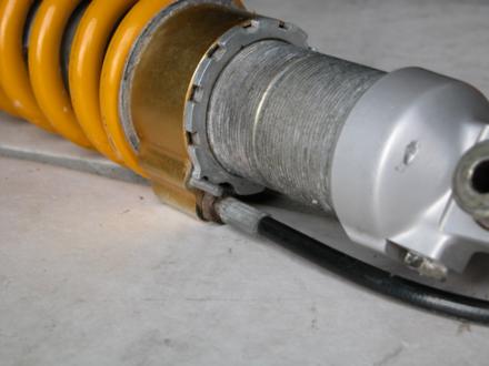

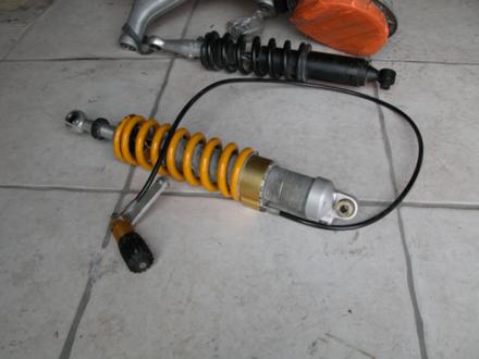

Can anyone help me with my rear Ohlins shock?
I want to get the spring off and then to be able to reset the ride hight when its all back together.
This is the model:
The problem is this little peg that locks the spring preload adjuster. Does it just screw out? Not having much luck and don't want to bugger it.

it needs a special spring compressor.
Bolicks. That means its not that great a bit of kit then.
If I want to swap between loaded with panniers touring and unloaded green-laning, I have to compress the spring past that peg to be able to adjust it?? :nenau

I cant understand the point of having an adustable shock that cant be adjusted on the road so I would suggest ( I am not a shock expert) trying to get the pin out, if it breaks then just order a second spring adjuster ring and use the two to lock together when you have found your ideal pre-load. Better find out how much the adjuster rinf is first Ohlins stuff isnt cheap.
John, the remote wheel adjusts the preload but I doubt that it will affect sag/ride height.
My mate that had the bike before, had the shock overhauled by PDQ but I recon he either gave them the wrong weight values, or they did it wrong. He weighed about as much as a greasy chip and was short of leg but he always had problems getting on/off and the sidestand let the bike lean like a Harley... whereas he could get on/off my bike OK.
PDQ cant set the sag as it needs doing on the bike so it would seem odd that the adjuster is locked.

Progress! I found a pdf copy of the BM836 (Para shock), Ohlins manual, plus a post I found on ADVrider.
When that big, remote knob is turned, the gold collar moves down from the knurled pre-load adjuster nut at the top, so increasing pre-load.
On the downside, it only moves about 3-4mm. I read it should be able to move up to around 9mm so it must have lost fluid.
Spring is also a bit hard - 689-31/95 198 - for my weight.
Looks like more money:( Best not tell the wife:cool:

Ohlins recommend that spring preload is 17 mm + - 2mm, that is why the remote adjuster only moves 4mm.
Ir you cant get the sag right betweem 15 and 19 mm preload you have the wrong spring.
