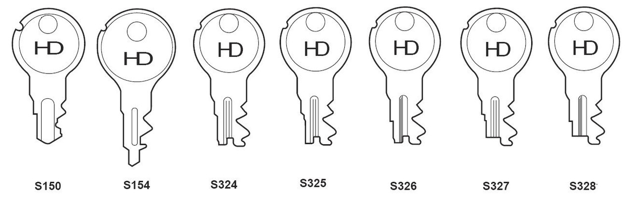

A quick bit of research suggests that the key will most likely be either a sudhaus key system DBGM S324 or S150. My guess would be S324, but that's just a guess having studied for 5 mins.

The S324 looks like this, but I would suggest that you make some kind of secondary device to lock the pannier to the frame as there is a long history of these falling off even when locked on! Cost me £400 for the contents years ago....plus the replacement pannier.This is what I made for mine.

I took a punt on a S324 and hey ho it fits just lucky I guess.
