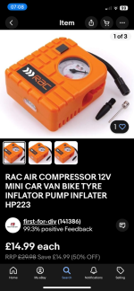

I’ve also got a small compressor that I’ve attached an optimate connector to.
Used it just the other day when a young lady stopped near Ladybower with a slow puncture.
