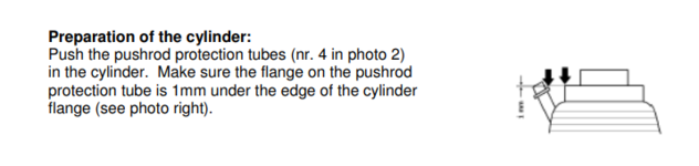

Have you checked that the pushrod tube are assembles into the barrels to the correct depth ? this gives the correct compression of the seal to the crank case ?

The push rod tubes are pushed too far into the cylinder barrel,
Or the flanges on the tubes have shifted ,both of which would not compress the seals sufficiently.

I didn't use any sealant, but the inlet is bone dry. So, it may be that the tube has been installed too far into the barrel and not getting enough compression.
Is there an easy way to rectify / check this without a full strip again?

Use a brass drift on the flange and try to push it down towards the block,mark the tube so you can see if it’s moving,nice and gentle,keep it square so the tube isn’t distorted or damaged
Edit,this will only work if the flange is a separate part from the tube,( most are)
Obv if the tube and flange are machined together it will not move.

Use a brass drift on the flange and try to push it down towards the block, mark the tube so you can see if it’s moving, nice and gentle, keep it square so the tube isn’t distorted or damaged.
I made some time to take another look this afternoon, got my hammer out, tapped the collar down by about 3mm and this appears to have sorted it. :thumb2
You can see in the photo how far I went. Many thanks for your input and advice gents, it's much apprciated.
