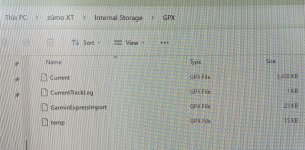

On the XT, the latest file is Internal Storage->GPX->CurrentTrackLog.gpx
Once this is full, it is shunted into Internal Storage->GPX->Archive->nnn.gpx - where nnn represent a 1, 2 , 3 , .... digit number. The XT keeps the last 20 of these - so when 21.gpx is started, 1.gpx is deleted. Can you see this when you connect your XT?

I hoped I’d find an Archive folder as I do have 23 Tracks.
But, no such luck. I’ve scoured the folder contents and my Tracks will not show up. Even though I can see them listed on the XT and each Track shows the blue trace as expected.
It remains a puzzle.
Ah that is strange those files look far too small for the unit to have stored anything. Obviously the data must be in there somewhere if the unit can convert it to routes. That has hit the buffers of my knowledge of the unit. Perhaps the best thing to do would be to back up everything you can and to a factory reset?
