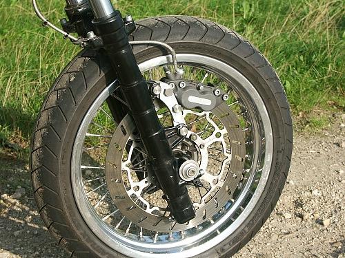

I have a 93 GS with the floating disk , and finding and fitting HH pads made a decent improvement for a small additional outlay over replacing with stock.
However , I paid around $28- to HPM for a nicely made adapter to take the six pot Tokico caliper found on a few turn of the century Kawasukis, and cheap and easy to find.
HPM is a vendor on the Adventure Riders forum.
With a set of EBC HH 102 pads in the new caliper there is a nice step up from the twin pot Brembo, for a modest outlay.
For around $100- I have a brake which has no trouble locking the tire, and I dont need any more than that.
Do you have any pics of that set up beemerboff?

Ive recently done the conversion to a six pot Tokico using the HPM adaptor.
For the brake line I went to JLS Motorsport AKA James Lister & Sons Union Street West Bromwich.Biker friendly outfit,theyll make up anything you want,on the spot.Even the fancy coloured ones.
I had a 40 inch brake line,banjo bolts banjos,all in stainless.
Tellem your trade ,get 40% off.Cost me just a tad over £20.
Took about 10 mins to knock up.

Had a senior moment,the adaptors the Harisson Precision jobby as per Adv Riders
