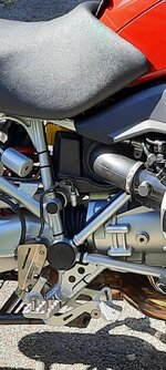

I have a 2010 twin cam GS, to which I fitted Fastway foot pegs. So much better than the std pegs.... They offer a nice wide place for your foot, great when standing up & are lower than std.
They looked like they would fit my Paralever GS ok.
I bought a S/H pair from this forum & they fitted perfectly.
To my mind they are alot better than Migsel type as alot wider & no sharp edges....
In a perfect world....for me.... they'd be an inch lower !!!
Ta for that. My long legs / knees need a drop in height.
Pete....
I had Migsel lowered ones on before I fitted the Fastways...
Fastways one is same height as Migsel...but loads better.
I'd just like another inch......

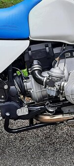

Just rebuilt an 87 PD, I fitted Fastway pegs, but wanted them lower.
Bought a pair of SWT pegs which were a good bit lower but very sharp jagged top. So I bolted a bit of thin ally chequerplate to them. Much kinder to the shins !!!20230724_173006.jpg
