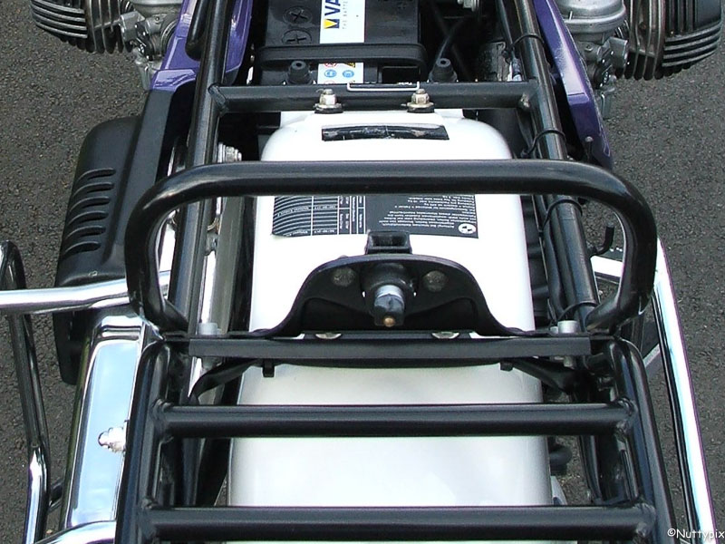

The locking mechanism is on a metal bracket that is bolted to the sub frame - but I do not think that you can get at the 2 bolts, (maybe also have "allen" heads) - but have a look and see if you can - but even if you do you will still have to get the lock off the seat with no key??

I've just been out to the garage to look at my 1995 GS, it looks like you may be able to undo the 4 bolts that hold the lock plate to the rear sub-frame. Mine has the nuts at the back and with a bit of patience you may be able to undo them and remove the seat and lock and start form there.

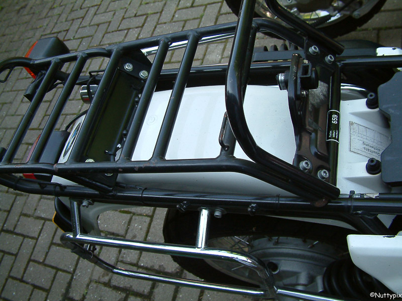

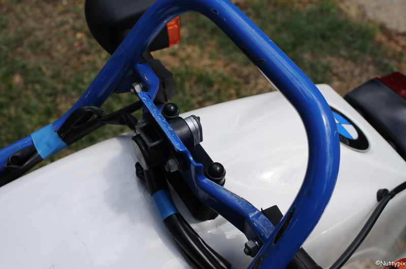

Any pictures, my lock is knackered too.
