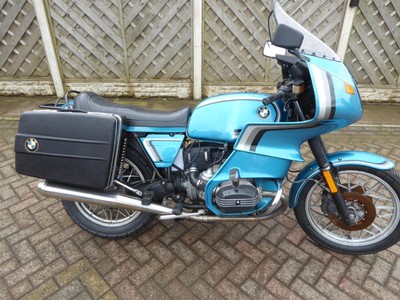

I'm aware the post '81 Brembo brakes are a step up over the earlier ATE set up, but I'm trying to get my head around what the difference in experience of riding/handling would be between the heavier & lighter flywheel (pre & post '81)
Anyone who's owned/ridden both care to share any thoughts?
