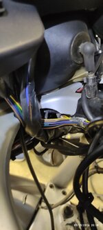

I am having trouble locating where the crimp is. There is a lot of the outer sheathing has perished and needs replacing.
Neil, looking at the loom while on the bike it looks like the main loom is on the left.
The bike has had a number of modifications wiring over the years before my ownership, so may have been moved slightly.
Hi,
Just re-read your post, and see yours is an 1100, so the loom might be on the LHS (Mine was an 1150)
You will need to trace all the brown wires to find the big join, but you're in the right area
