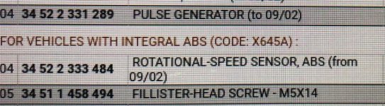

I need help to identity the correct front wheel ABS sensor for a March 2003 R1150 GS with whizzy brakes.
I have posted a WTB, but thought I might get a better response to a question here.
The fiche sites are ambiguous about the correct ABS sensor for an early 2003 GS.
Any practical advice and help with the WTB will be gratefully received.
As far as I am aware, the production run for the Twin spark with integral ABS (iABS) started in September 02. So if the bike is a twin spark , then the later sensor is the item required.
if your ABS ring is pressed stainless steel then it is the post 09/02.IMG_0571.jpeg
