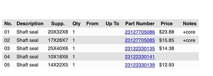

Looks like your shaft seal item 4 is weeping slightly.
A little bit of oil goes a long way and always looks worse than it is.
