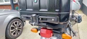

Good evening folks
I have managed to knacker my top box latch, I’ve done a bit of hunting online and seem to have found the replacement part number but can’t find anywhere to buy it.
I believe it is part number 71 60 7 654 346.
Anyone got any pointers ideas where I could pick one up?BA18079D-11AB-4C4C-B0B0-B9E67B4A7012.jpeg
The only thing I can suggest is you contact some of the independent parts suppliers like Motorworks, or James Sherlock or Motobins. They may have a second hand one on a damaged case.
Failing That, it might be worth a gamble buying a lock from the earlier cases fitted to the K series. The keys and key barrels are different, but the catch is a similar style and you may, depending on your skill level be able to make a functioning catch mechanism with parts from both catches.

Thank you Ian, I have purchased one and will see how I get on. It appears to look exactly the same, fingers crossed

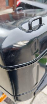

Had a disaster yesterday, box came off at 40k/hr lid ripped off when it hit the ground. I need new hinges and possibly new locking mechanism.
I did similar to my GSA panniers earlier in the year, Ryebrook BMW in Warwick sourced two for me. They still exist as spares within the dealer spares network 😉
As Ian posted above, I bought a lock and key set that fits K series and fitted it to my top box. Near identical and fits the same, note the lock set for the 1150 does not fit as the barrel is a different diameter than the K series, so you will have a different key (which isn’t a huge issue).
