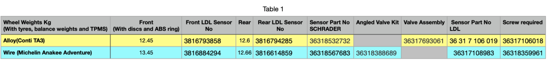

What age is your GSA? It's a straight swap as far as fitting but for the pressure sensors to work, the wheels need to come of a pre 2022 (half way through) and going on a pre 2022 or post 2022 wheels on to a post 2022. These have LDL sensors. Easy enough to change sensors extra cost needs to be factored in and the new sensors will need to be programmed to the bike.
If you need info, I've done it and have all the part numbers and process etc. Pre 2022 wheels, 2023 bike.
It's a 2021.
Part numbers would be very useful - everything I've looked at so far has the RDC sensor as a common part on the K50 and K51.
