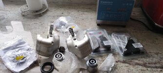

I suspect they are locked because of the swivel pin (3). Turn it around and you should see the caliber moving in and out.
I thinks it has been a combination of both the swivel pin, pot rusted and the seals.
I forgot to take a photo of the swivel pin.
New kit will be ordered tomorrow. 🍻
