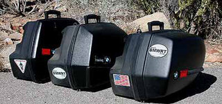

Another option?
If you are talking about System cases, then you can get a deeper lid for the pannier, which gives you more space. Got mine from main dealer and seem to recall it was reasonable cost. Just need to remove old lid and connect new one with pin through the existing hinge, took about 2 minutes.
What's the catch?
What?! :eek: Now that just sounds way too easy - too good to be true. :rolleyes:
No feckin about - just remove / replace lid.
:D
Looked online and can find nothing but ... Hmmm, wonder if i'll get lucky. :)
Ta for that. i shall keep looking now. :thumb2

It's called a Global Lid
Extra 6 litres of Pannier Space
Got them on the GS Adv
Put a pair on a get 12 litres more
Ah .... googling that specifically, got me a pic to compare. Thanks for that! :)
Now just to find a source to actually get one.... er, two? :confused: :D
