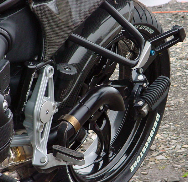

Or you could try something like this......;)
Small cost and sounds quite good too....
CC
