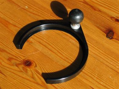

I just got a 2610 with one of MiGSel's neat Ram mounts. I really like the positiion of the GPS mounted this way but I can hardly see the maps as the ram arm seems to amplify the vibrations. It's a short (one to one and a half inch I'd guess) arm.
Has anyone else had this problem? Is there anything I can to to dampen the vibrations?

Is the mount on a 1200 GS or and 1150GS?
This is the MiGSel bracket..
Excuse quality of pic it is an enlargement from another pic.
I had this on my 1150 with the same 2610 cradle etc with no problems.

That's weird... There are quite a few 1100's on the road with this combination and I haven't heard the same complaint yet.
Is your speedo well secured?
Are the rubber dash mounts in decent shape?
No loose screws here or there?
It sometimes makes a difference if you move the unit a little bit. I once had bad vibes on the motorway at about 130 km/h. At the next stop I moved the unit a bit and the vibes were gone. It can be a case of resonance sometimes.
Do some checking and keep us posted please.
Cheers,
Michel
