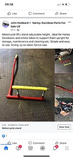

My Buddy and I always use something like this for rear wheel removal. Very secure, fast, easy. Just levers the bike right up. Something like this:
https://www.summitracing.com/parts/ptm-pp2906
The reviews on that one in the link aren’t good. My buddy may have made his - not sure where it came from.
Here’s a diy version. Pretty simple device really.
https://www.homemadetools.net/homemade-motorcycle-lever-lift
And that gives you enough height to remove the rear wheel of a Roadking without removing bags, fender* etc?
* sorry Wood Boy
* sorry Wood Boy
Height on the one my buddy made was fine - maybe 12”(?). Didn’t have to remove the fender at all - ‘04 FLHRS.
I had a Bassani RoadRage 2:1 (which was an awesome system, btw) and my bike was an inch lower from the factory than the regular FLHR. I did have to remove the left bag (quick release fasteners - easy), and undo the left support rail for the bag in order to get the axle out. I don’t recall if I had to do same on right side or not. Definitely didn’t have to remove the muffler.
A non-welding way to make one would be a 2-3 foot long chunk of 4x12 (I know - where do you get one of those from??), with a hole in one side big enough for a 5’ long length of rebar, with a bend in it about a foot from one end. You slide the wood under the bike, put the rebar in the hole, then lever it up under the frame.

One of these currently on sale...cheap. Not what I’d use, but someone might..
