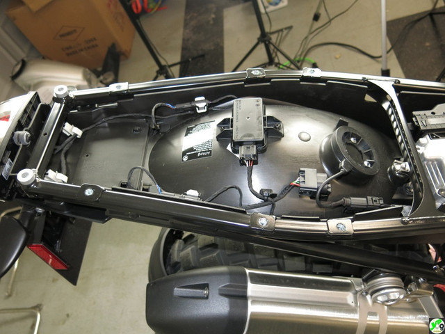

I keep my key in pocket trouser, attached with lanyard to my jeans, so not to lose, and picture of Knutk good info credit JVB in usa, fob antenna is round circle, and underneath is position for emergency key or fob with no battery.
I think we all have our 'special place', and the range for the FOB is enough to allow us to keep the key anywhere on our body.
Some of us also have made up an extra dummy key containing no electronics that allows us to open up the paniers, unlock GPS and unlock the seat without needing to ever remove the FOB from this 'special place'
However, as battery in the FOB is approaching it's end of life, the range for the FOB drops.
Knowing the antenna location may make the difference between allowing the FOB to be close to the antenna rather than mess about with the dead battery procedure...
