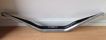

After 10k on my GSA I thought it was about time to fit some alternative bars as the standard bars were far to uncomfortable to put up with any longer. After trying about 5 sets of different bars I have finally fitted a set of Renthal 609 RC high bend bars.

I sourced some inserts from http://www.fasstco.com/ which were $26 per set, to allow me to fit the standard hand guards. The overall length of the inserts was to long so I cut them in half.

With the first few bars that I tried the problem with the hand guards hitting the screen was still an issue.
With the 609 bend this is not a problem.
I have been out and done a few miles with the new bars and well happy with the difference.

The Renthals have a reduced sweep which is what I was looking for and they are significantly better than OEM bars, greatly reducing the pressure on the outside edges of palms.
