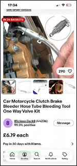

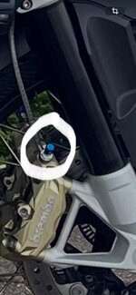

A cheaper option https://www.goodridge.co.uk/products/v-twin-bleed-nipples-speedbleed?keyword=bleed nipplesIf you can afford it, replace the bleed nipples with Stahlbus Speedbleeders. Available on eBay or maybe through Motorworks.
This will completely eliminate the need to repeatedly open and shut the bleed nipple whilst bleeding.
You open it once, and a small spring loaded one way valve does the rest.
