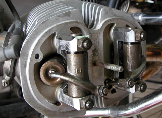

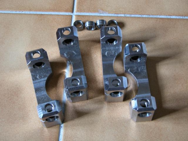

I just got these from a guy in Germany that makes a batch now and then...
Something to play with this weekend;)

So . . .
What are they made of ??
And
What is the advantage over the standard rocker mountings ??
(They look nice though, pity they can't be seen in use :D )
Bob.
So . . . What are they made of ?? And
Steel of some sort as opposed to cheese:comfort. CNC machined.
They are supposed to significantly quieten the valve noise. Rocker end float is adjusted once and that's it... I'm told...
Its easy to sell me shit like this because I hate mechanical noise:D
John
John
He too! Let me know if they do make the top end quieter. I will have to invest for my planned winter o/haul. The next "noise" on the list will be the g/box when in neutral at tick over. That is driving me NUTS!!!!!!!:(
How much?
Well... considering MotorenIsrael sell them at €199 I thought that €120 was "reasonable". Plus P&P
If you are interested in the future, he only advertises them on the German 2-Valve GS forum. Dunno when the next batch will be...

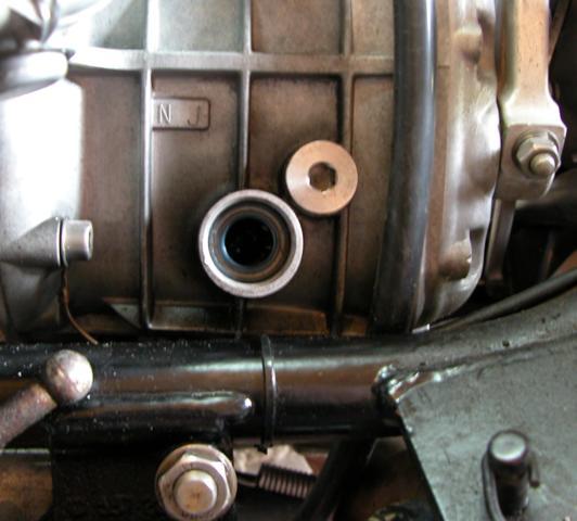

Some bits are well lubed... Hall unit O-ring weeping... gear selector shaft seal weeping... oil pressure switch weeping from the switch, not the crush seal.

Oooh! I like those :drool
Could be just the thing to quieten down my Mono's valve gear. I've tried everything else but the 80 engines always seem "tinkly" when they get hot.
i've spent ages tinkering with rocker end float and never made a scrap of difference to tinkly top ends.
i suspect worn cams/followers are really to blame.
AAMOI guzzi moved from steel to ally rocker supports in about 83, supposedly so the expansion rate was the same as the head. they said it made them quieter. never noticed any difference there either.
edit: just been looking at a genuine bmw G/S riders handbook and valve clearances are given as 0.1 inlet and 0.15mm exhaust. i know that later it was changed to 0.2 exhaust. i also know that a clearance very slightly bigger than 0.2 causes LOTS of top end rattling, so maybe going back to the old figure is the way to quieten them down?
also in the manual was this gem re. using the kick start: "depress the the pedal with the full weight of the body to start the engine. if it fails to start, wait for the crankshaft to stop rotating, and repeat the attempt".
whoever wrote that had never actually tried to kick start one, had he? :)
i've spent ages tinkering with rocker end float...
Likewise. Anyway, they are on now and it does make it really easy to set the end float. None of this pinching posts together malarky for me from now on;)

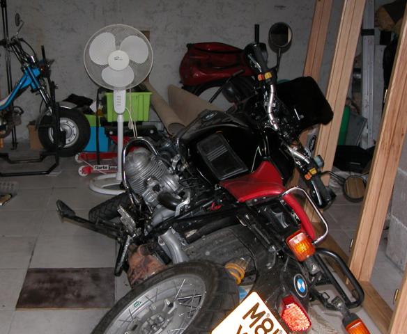

While I was at it, I threw the bike on its side and replaced the gear selector shaft seal and oil pressure switch. 10 minute job:D
