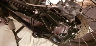

However, just wanted your opinions on these pictures... This is what it looks like from the outside at 12000 miles

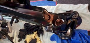

... and once opened up, I was rudely awakened to this mess !!
On closer inspection, the rubber gaiter had a very small split in it, right on the crease line where you wouldn't see it.
It looks like water (when washing and riding in the rain) had dribbled inside and sloshed around causing all this? :nenau

Yup, and how many on here have drives in a worse condition that that ? Probably some of the same muppets that blat on about "it's chain drive so a deal breaker for me" when looking at anything other than a GS.......
The chain on my Africa Twin is immaculate :D :D :D
I'm not bashing shaft drives by the way, I love my GSA, but I would NEVER have known what was going on, you can't see that split from the outside until that gaiter is removed (if indeed it's the cause anyway).
Im no expert on these things , but isnt there a risk the corrosion has attacked the hardened surface of the gears, leaving untreated metal exposed. If this is the case, could it lead to premature wear?
Only ask as my pal with a Triumph had water leaking into a gearbox and same thing happened.
Steve
Nice info, next step take the bugger to BMW and get the gaiter replaced and the rest inside sorted under warranty, that is what they take the extra price cash for.
Split boots are very common, frequent checking is required.
Surface rust
The drive shafts on rear wheel drive cars and trucks are not protected by a housing, they are exposed to the elements
The universal joints and sliding joint are designed to operate under these conditions
It does look like a rusty mess and a bit of paint would have been nice, but it’s not meant to be visible
The inside of the UJs will be perfectly OK and I don’t think the splines on the FD slide as it’s a paralever (visibly they are too short to be a sliding joint)
A bit of grease on the splines to stop them rusting and off you go :thumb2
yuck!... Did you take the shaft out?.. only 5 mins more to get the full unit out. As you see in the other post you mention, the shaft is also devoide of a good paint job so rusts like mad. I covered my unit if thick waterprofe grease but may take it off again this winter and POR15 the thing.
Splines will be fine I'm sure but better now you have m77 on them IMO.
I just didn't have time, on this occassion.
The bike is getting a 3 day overhaul. 12000 mile service, new paint job... so tons of parts to be fitted.
I'll take it out next time, and I'll be prepared for more time to deal with it.
The bike is getting a 3 day overhaul. 12000 mile service, new paint job...M136 AT4 armament....etc
Fixed.
too right, I've recently just had to replace them on my 28 year old R100GS for the first time :)
Yeah but the split happened 27 years ago and you’ve only just noticed it ;)
